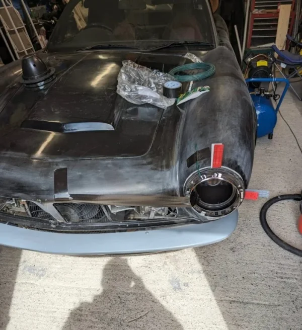

Apparently my phone didn't keep the photos I took.
I've fitted the wiring to the car side of the loom using a 7 core trailer wire. I've run it from the passenger side, along in front of the radiator and then down the side. I've got a 7 way connector block that I'll use to connect the wiring to the loom on the bonnet - that way it'll be easy to take the bonnet off at a later date.
I've glued conduit to the underside of the bonnet and run the cable inside that for the lights.
There's a lot of sanding and filling to do so I'll get on to that before putting the actual lights in and refitting the bonnet to the car.
I've also got the indicator cowlings to fit (somewhow) and lots of gelcoat to redo.

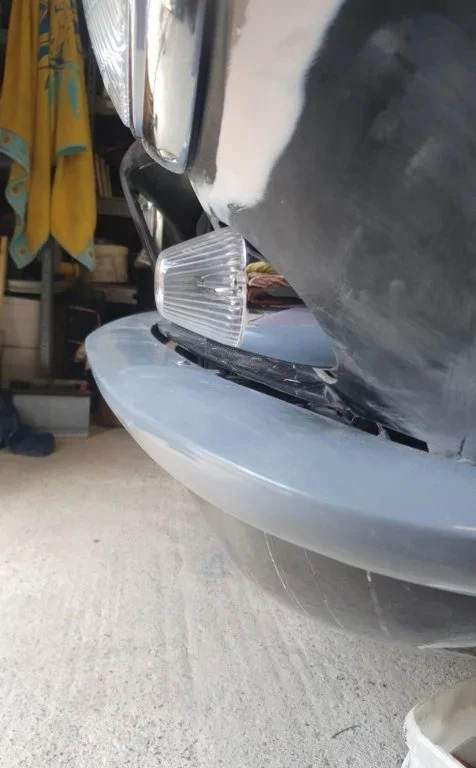

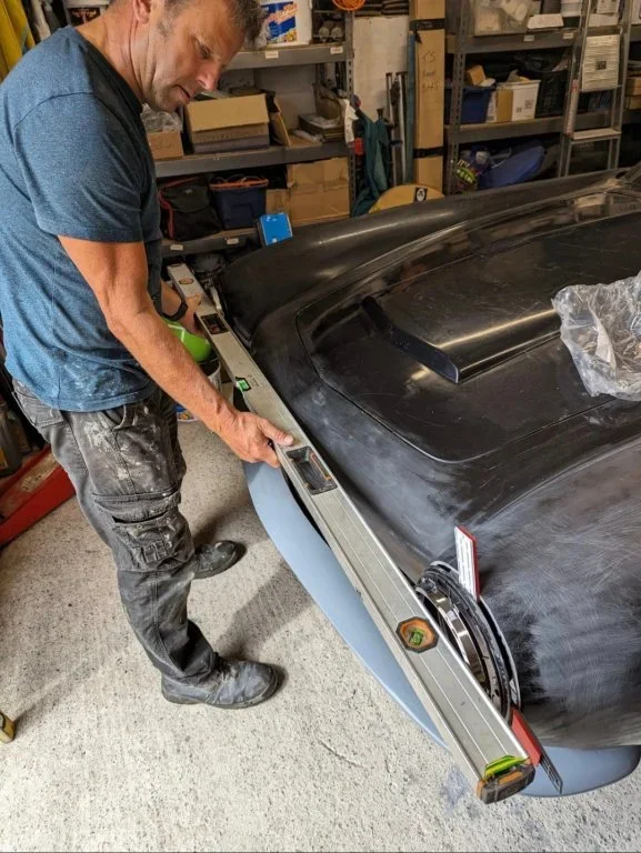

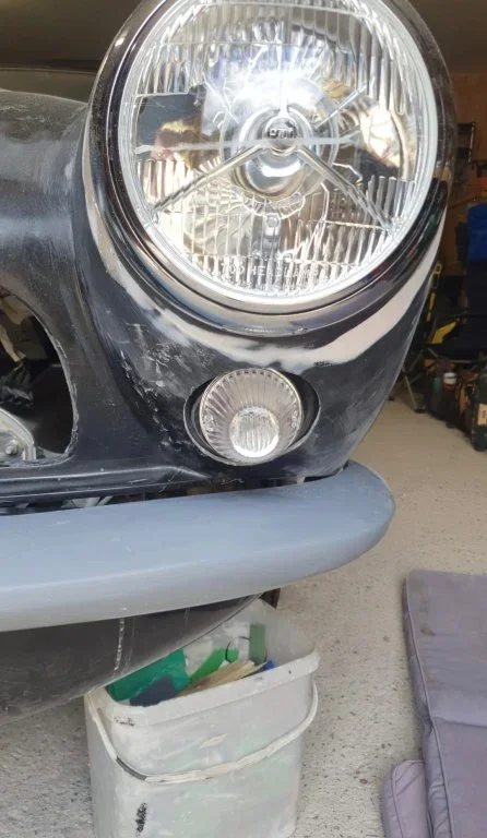

How was the mould for your headlight surround. My offside was fine but my near side was 15mm out of plumb, meaning that it was pointing upwards slightly. I ended up cutting 5mm back to retain the bezel and building the top out.
Had a nightmare with the karmann ghia indicators. Mine was the prototype so i think is a slightly different shape to Dans. When offering them up they pointed downwards. I've had recess them to get them looking straight.
163
Pontrhydyrun - in Crow Valley
My kit is just a week old and my nearside headlight is a bit wonkey too.
Top half of the headlight mounting surface looks straight but bottom half sticks out a bit.
I'll chop out that crescent shape you see from the underside and push the front surface back straight.
As for front indicators. I'm not going to bother with the VW slopey shaped ones. I'll either go for straight lucas style recessed. Or go full modern LED headlights with halo daytime driving lights and built in indicator.
Not decided yet. Might fit modern ones just to get it drivable while I make my mind up.

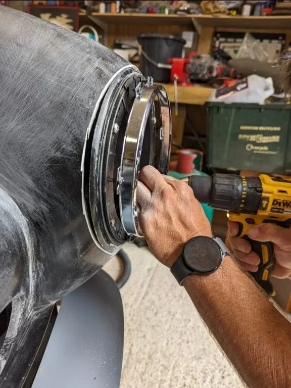

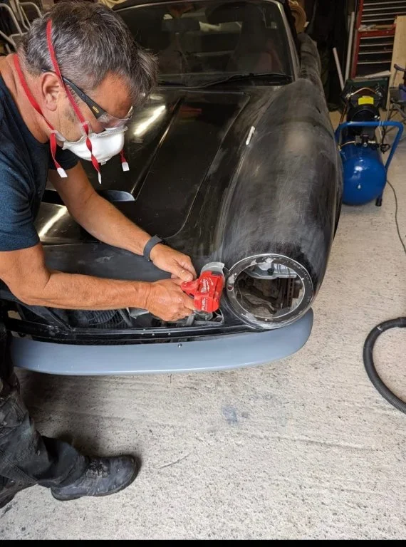

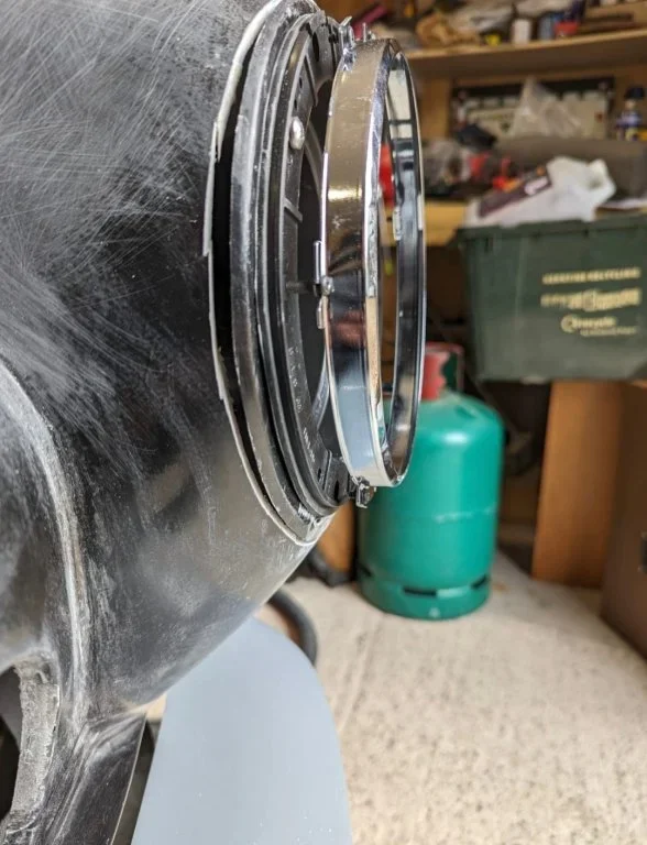

I've attached some pics.
I fitted the headlight bowl to make the cut section more stable, then used packers to get it right, then a bit of fiberglass filler dotted around to hold it in place, removed the packers, fibreglassed the inside and fibreglass filler on the outside.
