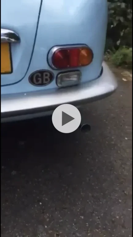

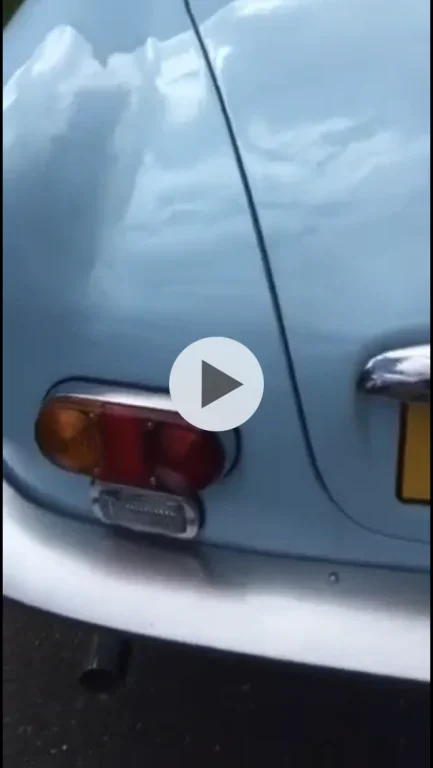

You could move the lights above the bumper they look good higher up.
I might get reverse lights to go there, Steve has done this and the blue car that’s also finished

Ah, hadn't seen that before, was looking for something period (hence the chrome), well I'll se what it's like when I get her down.
