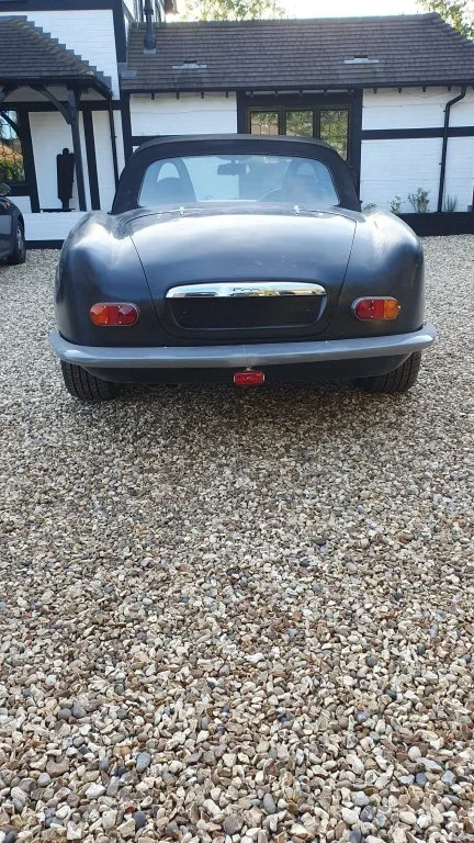

I'm still waiting for my reversing lights to arrive. As Dan mentioned, I'm having the ones that sit under my rear lights. Originally went with Pirans one of each but then backtracked to 2 reversing and 1 central fog light under the bumper. Gone for vw t2 reversing lights as they look similar to the original 507

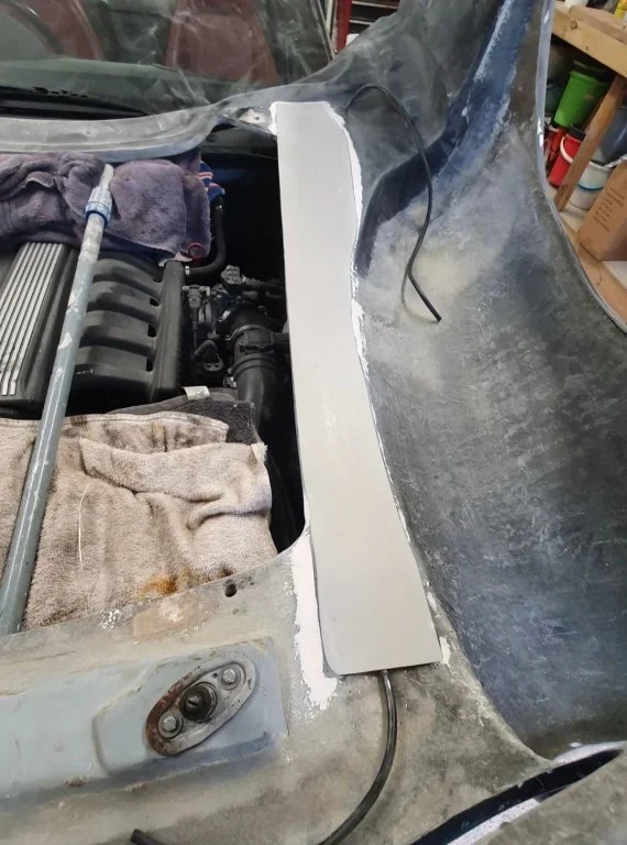

I ran my cables from each side. I didn't want to see the cables under my bonnet so made a template and cut some thin fibreglass sheet which I tiger sealed to the hollow in the bonnet having put draw cables in 1st.
The pic shows the bonnet flipped over as it was easier to do this way. Front headlight and indicators are connected up now. I've left another draw cable in each side so that I can put front fog lights in at a later date.
Everything will be flowcoated black when finished
