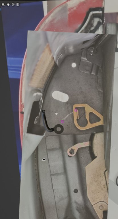

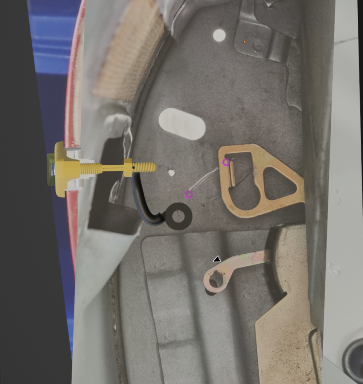

Hi Ian,
I might be wrong but I think your handle is too high, but I'm widely open to persuasion.
The first composite image shows the outer door skin in red on the left, so a drivers side viewed from the front of the car.
In yellow, in the middle of the red door skin on the left is the shape of the 507 door handle with the lever and screw thread and the cable clamp hole cut out clearly visible.
To the right and also below are a couple of pinky / purple circles and a scratch line between the two. You can also see the Z3 lever which is what has to move to make things happen, it's also a brassy / yellow colour. The Z3 lever has to follow the scratch line between the purple circles.
You can see, in black, the cable guide which points at the purple circles.
If the handle position moves up or down from where it is currently shown then the bit of the cable guide which aligns with the position of the door handle's cable slot also has to accommodate that shift. Longer if it goes up, shorter if it goes down.
Below is much the same image but with the handle bit removed and a black marker pen where it was which shows the 235mm position. You can see that it is well aligned with the top purple circle.
So the critical issue is, where, relative to the Z3 lock lever, particularly the top left corner seen from these images, is does it sit?

I've looked at other photos and I agree with Ian @Duncodin I'll adjust the design to raise the centre of the handle to be 225 along the surface of the body. That should place the bottom of the handle just above the swage line.

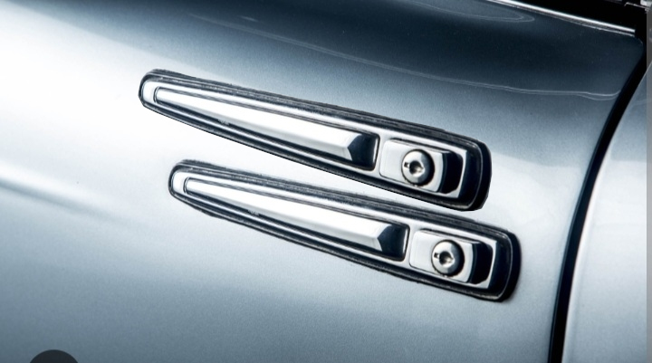

In terms of handle position, most pics I've seen are about an inch above the swage line, which I like and would be happy with.

Krähental
Design drawings etc showed it directly in line with the swage line
Above is directly in line with the swage line.
But for production it was moved up an inch or so
And here's the assembly line making it so

Krähental
I once saw an early photo of a real car with the handle directly in line with the swage line as per the design drawings. Musta been a prototype. But the light was reflectinģ off the top of the swage highlighting that top surface which, kinda, made it look as though the handle was below the swage if you know what I mean. On paper it looks nice but in life it looked strange.
