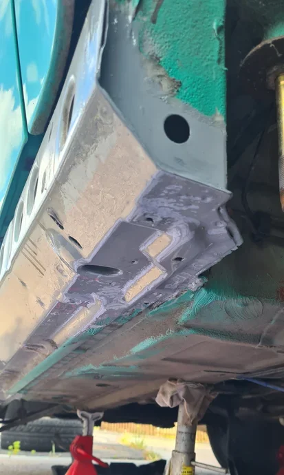

so with that over, it was back to pulling loose seam sealer and grinding back as many areas as possible that had cracked sealer or paint..
once ground down to shiny metal in all the loose places, it was time for the Red oxide primer... if your wallet allows and you don't already have one, I can thoroughly recommend a belt file sander..... gets into all the nooks and crannies and you can swap different grades of belt
so more red oxide primer !!.... and yes I am replacing the shocks
