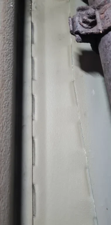

I also seam sealed the end of the sills both front and back and well as the two rear spring perches. didn't photograph it though...
I also had a bit of a setback... I went back to my "favourite" front offside Sill end and looked underneath, and to my horror, there were three small brown brown areas on the Epoxy primer !... again !!.... this time I ground down the whole area, and got it as shiny as I possibly could given the rivulets and my dodgy welding.
I tried something different this time and caked the entire area in Kurust... I'll leave that until tomorrow and go over what I exposed today with epoxy primer

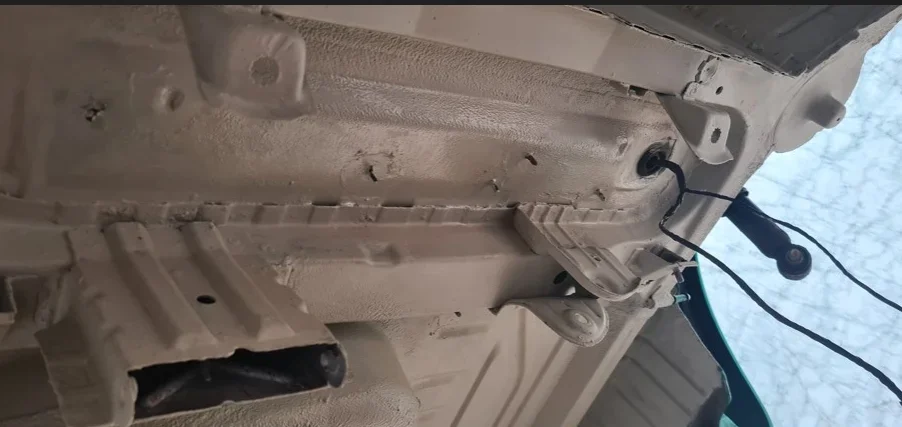

well..... another few hours under the car with a couple of revelations........ plus !..... we have started the....... TOP COAT !! :party:
ok things started a little fraught.... I was checking the clips and runs for the brake pipes and fuel pipes and noticed this rusty clump which got me worried. I dug at it gently with a screwdriver and luckily it was rock solid. it's where the undertray clip to the body. so there must be a little moisture trap there.
so it was out with the trusty file sander as it's nice and narrow and can get into all the little crevices.
then a liberal coating of Kurust which I'll let do it's thing until tomorrow then go over with MIPA epoxy primer...and of course stippled seam sealer and anti gravel before top coat.
while I was under there, I thought I'd crawl forward and check the front... had a little dig around the cross brace and...........oh.....the oil leak is deliberate by the way... stops rust =))=))
so it looks like I'm on the hunt for a new cross brace... luckily as we know it's not structural and only held on my 4 bolts so easy fix... he says.
I also bit the bullet and decided to BUY new zinc plated Bolts of Doom.. these are M8x20, but... for 2mm ?... shouldn't make a difference....
Think they look rather fetching in their new home...

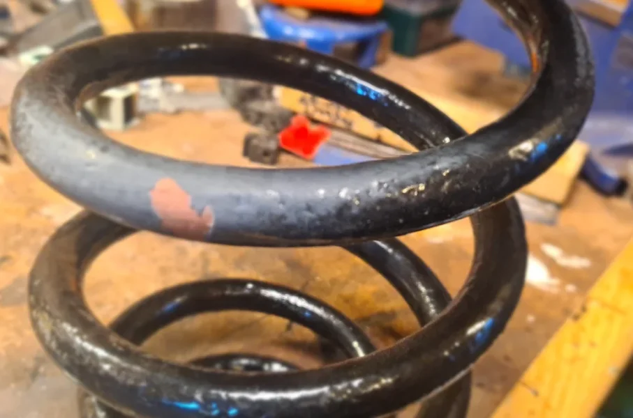

I also took the heat shield off behind the cross brace and.... wow !!... the undercoat looks factory fresh !!.... the E-Coat certainly did it's job there !!
now to the bit where I got a bit carried away..... I saw the Fiji Green cans on the shelf and thought... "oooh let's see what a quick spray looks like..."
A little bit turned into a bit more... :whistle::whistle:=))
the top of the arch (the grubby bit) is original paint and I'd painted the spring perch, colour match is superb, and yes I am replacing the shocks
I then had to stop myself doing anymore, firstly as I was spraying under a tarpaulin with no mask, and secondly I hadn't masked anything up !
might carry on tomorrow !

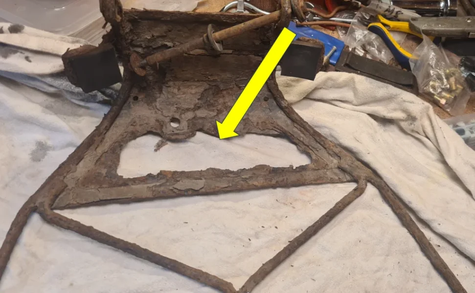

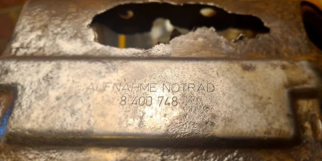

whilst mulling over the mysteries of life and the universe, I spied the spare wheel cage, remembering there was a powdercoated one on the For Sale page... I decided I'm going to have a go at restoring mine !
yes.... it is that bad
you might juuuuuuuuust see a tiny hole, so small I had to mark it with an arrow.... yes... that's not supposed to be there. So I get to practice my welding again !!
however !!.... much grinding later with the angle grinder and wire wheel cup got me to this
and I even managed to expose the part number
one piece of equipment I found REALLY good, especially if you wear glasses and a mask... this face shield is brilliant and can highly recommend and it's very comfortable to the point I forgot I was wearing it and hit the Perspex with my Cuppa !!
so with most of the grinding done, I then started on the swivel bolt... and … yes.. I think I've found my next zinc plating victim !!
Actually thinking about it.. I might just chop this bit out, i mean what's it doing apart from being a water trap ?

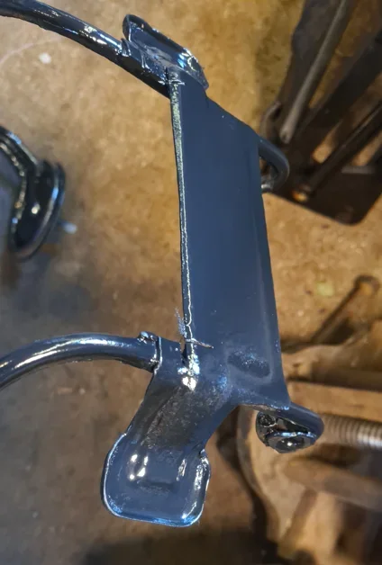

therefore I decided to carry out my threat and save the Spare Wheel carrier by chopping out the rot
angle grinder and cutting disc made light work of it......
tried peeling back the left overs which was mildly successful until I got to the spot welds
then it was the joys of stripping all the grot off with the angle grinder and wire wheel cup. I used my file sander to smooth off the sharp edges of the bits I cut off....
Finished off with a coat of black Hammerite Stone chip which actually made it look like it was powder coated.... nearly...
tomorrow I'll flip it over and paint the top side.

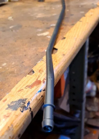

Storm Darragh stopped play today as I had intended to put the brake unions on the pipes, flare and fit onto the car but it remains firmly covered up !... BUT... that doesn't mean progress can't be made.... decided to tart up the fuel pipes that @Mazza got me. Absolutely nothing wrong with them other than a little surface rust and a bit of bubbled paint....
So I took to the pillar drill with a bit fat brass wire wheel and set to on the pipes
The aim wasn't to get them sparkling clean, but enough to make it feel smooth
then it was out with my new favourite spray.... Black Stone chip !.... makes them look brand new !
