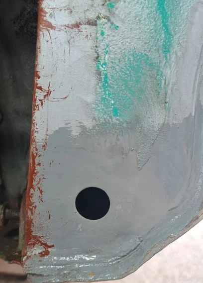

Firstly, a quick check to see how the POR15 is fairing up after I put it on in June..... Front offside Sill, which I welded back up...... I have brown spots leaking through !!..... now this is probably due to my workmanship as the other three sill ends are fine....
what I think I'm going to have to do is grind this area down and use my MIPA Epoxy primer instead and see how that fairs.

Another day of Epoxy priming !......going on from yesterday with the rust spots, bleeding through the POR15, today I ground each area down to bare metal again using the file sander, to be met by corrosion !.... managed to get to bright steel, then added a good layer of MIPA epoxy primer. I will add seam sealer in the corners and anti gravel spray later

Then scuffing up the lovely POR15 coating, so I could add Epoxy Primer to the Sill ends
