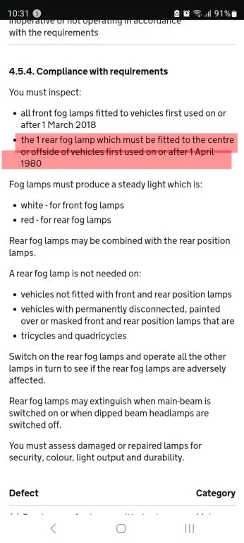

My mot tester has come back with this. Z3 is after 1980 so his view is centre to offside for location. He's not aware of the 250mm requirement as he's said that most modern cars have their fog lamp in a cluster which is higher than 250mm off the ground.
